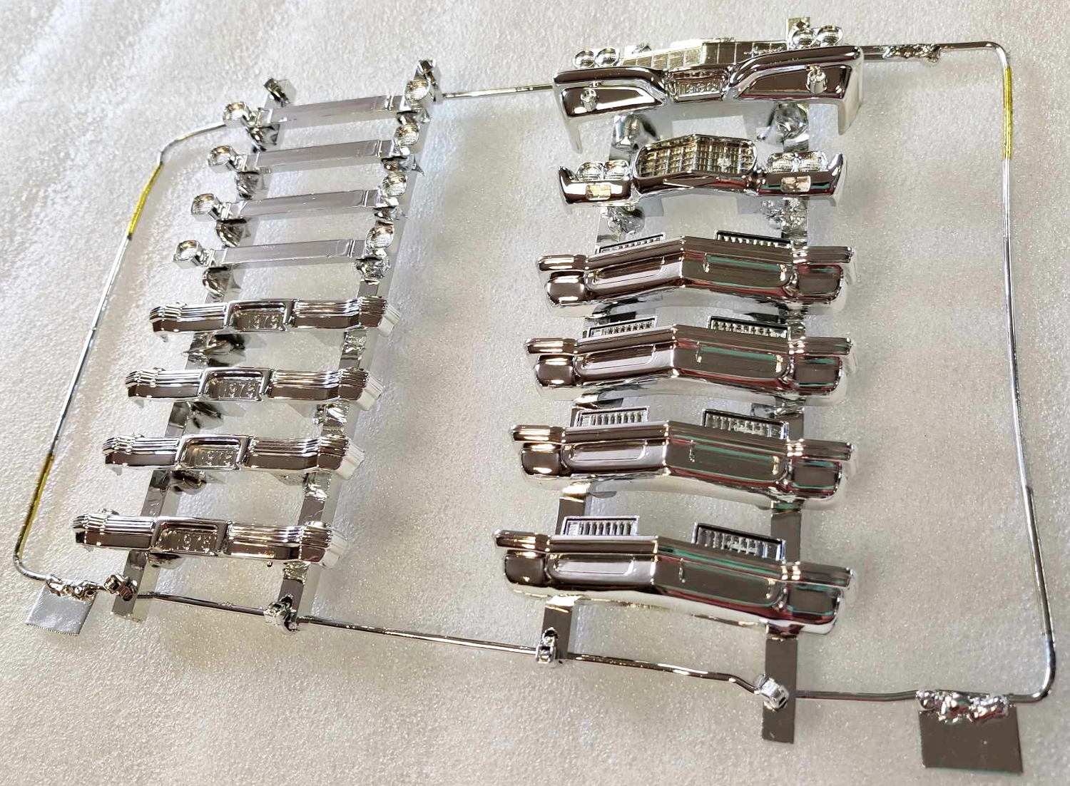

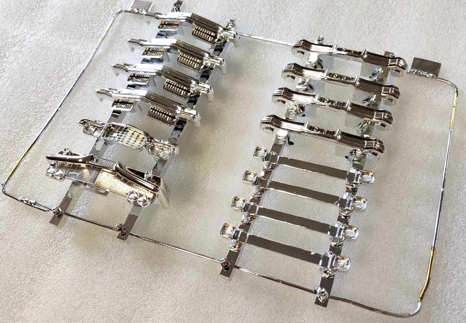

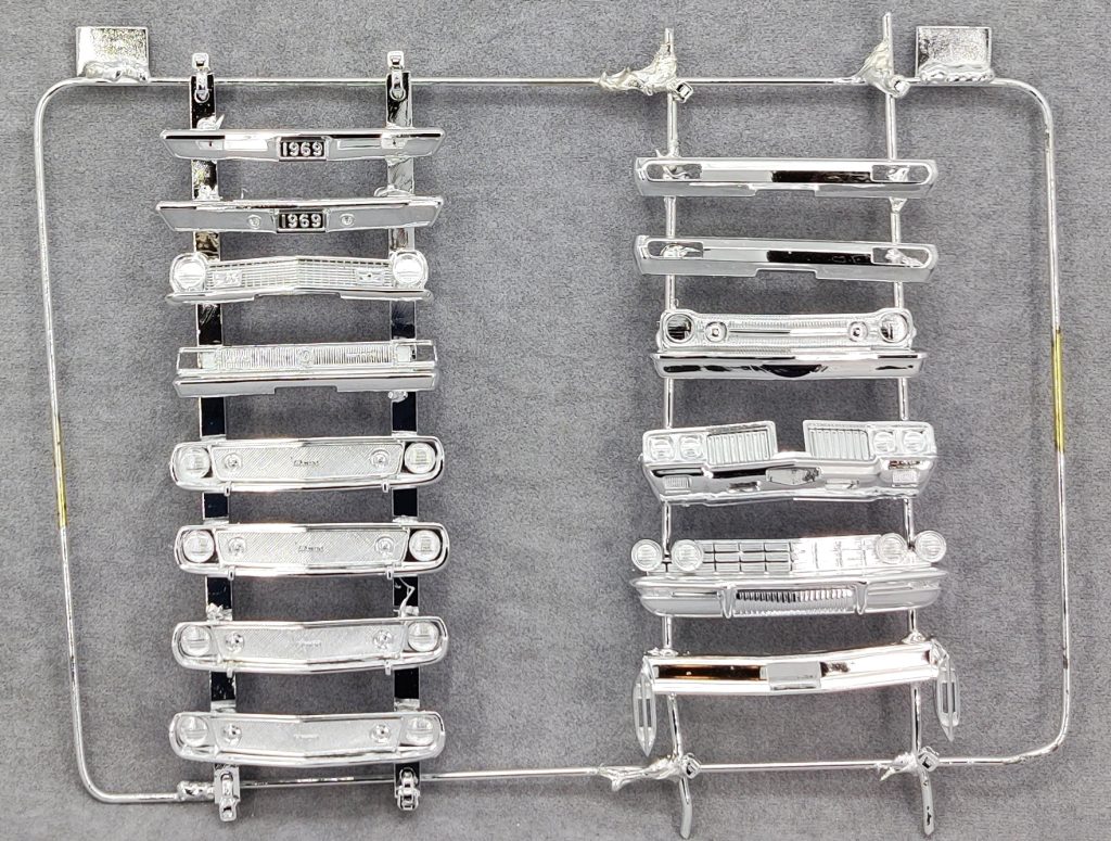

Parts can be mounted on wire frame no larger than 6” X 8” (outside dimensions). Heavy-duty wire coat hangers are an excellent source of material. The over lapping ends should be on an 8” side for maximum strength and stability. Overlapped area can be secured with zip ties, wire, welded or soldered.
Cross- pieces can be either more coat hanger type material or a plastic structural shape such as Plastruct. Round pieces are acceptable for “stringing” promo bumpers together, but square,” T” shaped,” I” shaped or flat pieces should be used on other pieces for maximum protection against lost parts. Wood or any other porous substances are not acceptable for mounting material.
Wheels and hubcaps are best mounted on parallel rails; fastened on either the backside or an edge where the tire will cover the bare spot when remounted. Wheels and hubcaps can be mounted with as little as one eight-inch separation between them without affecting the finished product. GE Silicone II Household Glue or similar product is the recommended material for mounting all parts on your rack. The “tacky” type craft glues are not recommended as they are a water-soluble adhesive. Our experience has shown that parts become loose and fall off the rack as they are being cleaned prior to coating when this material is used. Hot glue is also not recommended. DO NOT USE RUBBER CEMENT, SUPER GLUE or ANY TYPE OF TAPE!!
Bumpers and larger parts should be separated by about one-half inch. An adult size finger makes an excellent and handy spacer. Placing your finger between parts when mounting them will maintain the appropriate spacing required for best results. The ends of the bumpers should be separated at least three quarters of an inch.
  • The finished sides of all parts MUST face the same side of the rack.
  • Parts cannot be mounted on both faces of the rack. The back side must remain unobstructed.
  • Leave plenty of space between parts. The finish will be inconsistent if you try to get too many pieces on a single rack.
  • You must leave a one inch space at two corners of one eight inch side in order to secure the rack in the chamber
